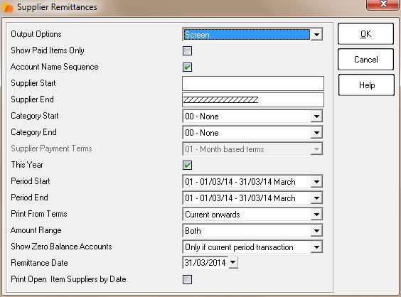

        Hi Sthembie - are you are using the Supplier Accounts to enter you Supplier Invoices and payments?
        If so - have you updated them? If the batch has not been updated, then they will not reflect in the remittance.
        If you do not have different categories, then you will not able to change it from "00-None".
        This is how the window might look:
        The other option could be if you have your Suppliers entered as General Ledger Items and are doing the processing via journals. If that is the case then you will not be able to print remittances in this way.
