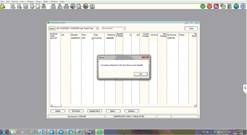

                        Interstore Batch Error, Partner Version 14.1.4
                        All's well that ends well. Farhad's database had some corruption in it which I managed to fix.
                        The problem had me going for a while!
                        Hi Neville, 5 years later, 3 versions later I am having the same issue of failing to do Interstore Transfer Journals after renumbering my store codes from Alphas to Numerics
                        Under Edit > Inventory > Stores all stores are listed being 001, 002, 003 however any processing screens do not show these stores except 001
                        I have noticed also under Setup > Users when i try to link users to stores the new stores (numerics) do not show while the old ones (alphas) show
                        the attached error shows when trying to do any journal processes
                        P.S I have literally gone via every possible table to look at where this store linkage is without luck
                        Will appreciate your assistance
Name:	store issue.jpg
