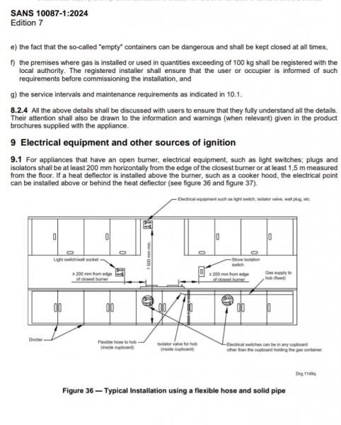

    Ok. Attached is a page from edition 7 as forwarded to me by a gas installer.
    It talks about at least 200mm horizontally from the edge of the closest burner.
    It does not however mention to the left or right if viewed from the front, so , if the back burners are more than 200mm from the wall, then the isolator , if mounted on the wall directly behind the hob does comply with the 200mm horizontal measurement.
    What confuses me is the 1500mm from the floor.
    Any thoughts ?
  6. #6
    Jun 2017
    Port Elizabeth
    1,440
    40
    Any thoughts ?
    Can only shake my head in bewilderment - Gas guys should stick to gas and not interfere in electrical regulations
    Somebody dropped the ball and as far as I am aware the gas and ECA were talking to align the regs - this is going to create even more issues
