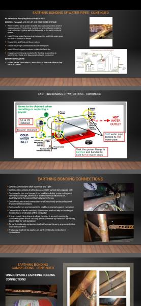

    I am currently busy with the unit standard assessment and this presentation came up on the subject earth/ bonding of geysers see below slides of correct procedure

    Sorry i see the slides are not very clear but basically hot and cold water pipes needs to be bonded as close to geyser as possible even the geyser flange needs to be bonded to cold water pipe with bamba straps using brass bolts and nuts. Then 2.5mm green/yellow or bare copper conductor back to db main earth bar. Wiring needs to be dedicated with earth leakage protection and curcuit breaker and double pole isolator close to geyser flange. 2.5mm Surfix or flat twin+earth the earth conductor must not be used for main earth of geyser the earth conductor is not 2.5mm. Bathroom zoning was also part of this presentation,ip ratings and electrical installations in bathrooms very interesting.

    hot and cold water pipes needs to be bonded as close to geyser as possible even the geyser flange needs to be bonded to cold water pipe with bamba straps using brass bolts and nuts Then 2.5mm green/yellow or bare copper conductor back to db main earth bar.
    I don't agree that strap needs to be used and back my statement up with with Note 2 under 6.13 as pasted below
    6.13 Bonding
    NOTE 1 The aim of bonding is to bring all the bonded parts to the same electrical
    potential.
    NOTE 2 No external conductor is required if compliance with the requirements for
    continuity can be proved by the test in 8.6.2.
    Agree that a dedicated circuit but more than one geyser can be on the circuit
    6.16.2.2 Dedicated circuits shall be provided for water heaters and there may
    be more than one water heater on each circuit.
    6.16.1.4 The disconnecting device shall be positioned
    a) within 1,5 m from the appliance,
    No where in the regulations is there a statement that says you may not use a wire size less than 2,5sqmm to earth a geyser
    To bond a geyser yes - but if the geyser is bonded due to the copper pipes been bonded elsewhere and the readings being OK , then I should be able to earth the geyser with less than 2,5sqmm
