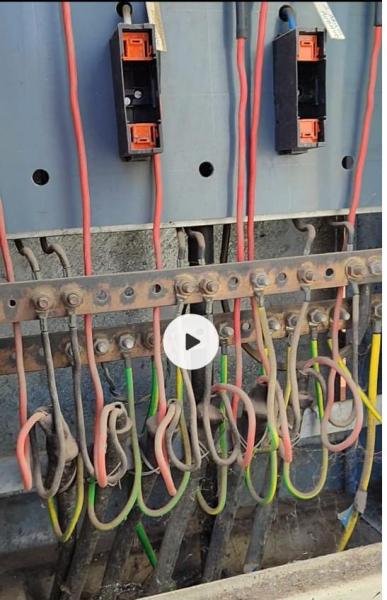

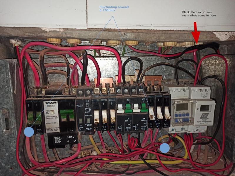

    Can someone confirm if this is TNS earthing by looking at these pictures? (and not TN-C-S)
    This is a picture from the outside mains distribution board on my street. I'm in South Africa.

    Below is a picture of my home distribution board.

    Looks TNS from what I can see, does not look like the Neautral and Earth bars are joined
