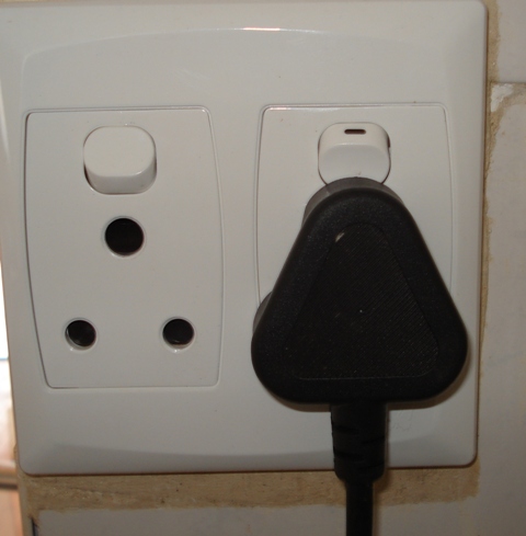

    sabs approved socket outlet
    can someone please tell me how sabs approved this plug socket...it is an MES double socket outlet...SABS approved
    how do you switch off the socket when the plug is inserted?
    There's a lot of useless SABS approved sockets on the market coming from the far east mainly. The CBI range are also poor although not the worst.
    Maybe the one pictured is designed so you can use the switch lever to help remove the plug....then again maybe not.

      it seems sabs have also figued out how to make money...who cares whether or not it works...so long as someone signs the document approving equipment...money can be made
      • murdock
        • Oct 2007
        • 2346
        this socket outlet is the cheapest and of course the best seller at the wholesaler...now how do you issue a coc if the socket is sabs approved but the switch cannot make and break while the socket is inserted according to section 4 tests number 14 all switching devices, make and break circuits...by the way this is my test plug for cocs...so now what do i do become a crimminal like all the other people mentioned on this site...and do i just sign off the coc...what do i do?
        the right thing to do is remove all the sockets and replace them with ones which make and break...eeeeish i am sure the customer will say no problem just send me the bill

          the feed back i am getting is that it is not SABS to blame...nor the socket manufacturer...but the appliance company who fits the plug top to their appliances.
          i checked all my plug tops at home and found i have the same plug tops on all my new appliances but my sockets are the old lumex type with the switch on the side.
          i am trying to understand how this whole fiasco came about...maybe someone can explain to me how sabs works...because i must be missing something.
          i would asume they have a standard for the plug socket sans 164 which must be a specific size so that when someone makes a plug top it should fit in so that it doesnt hinder the operation of the socket and switch...
          before you can sell a product in south africa all components have to be tested by sabs and passed..am i on the right track here...the way i see it the sabs are to blame because when they issued the certification for the appliance with the moulded plug which comes as part of the appliance someone didnt do their job properly...or the company which makes the appliance has changed the plug top supplied with the appliance...and they are responsible.
            More commonly known as "passing the buck"
            EDIT: Another thought - It might be cheaper to have the client change all their plug tops to fit the plug outlet. And we don't issue COC's for plug tops and therefor can't be responsible for over-sized plugtops.
            Now how's that for passing the buck?
              .......we don't issue COC's for plug tops and therefor can't be responsible for over-sized plugtops.
              Lol, That's actually a very good point. There would be no reason under the existing legislation to fail the sockets on a COC because the appliance plug is exempt from any testing or inspection.

                I cannot resist: Is the plugtop SABS compliant? That might be the reason. The way things are in sunny SA it could very well be the socket outlet though. There are plenty of products that do not meet the standards on the market. The most common of all is the bedside lamp in most houses with a brass lampholder that is wired with ripcord. This is a sore point for me as the brother of a friend electrocuted himself with one.

                    what about clipsal s2000 plugs.i find that if i use my plug tester which comes with a moulded plug top then it shows no earth.if i pull the plug out slightly the earth makes contact. the moulded plug top earth pin has metal on the front part of the pin and plastic the rest of it. a lot of appliances have those types of plug tops.
