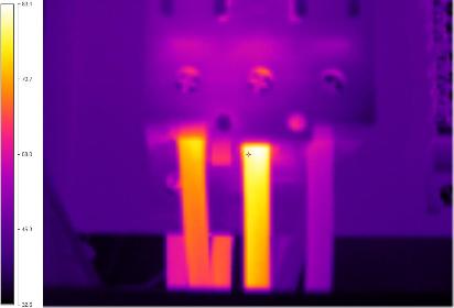

    i am thinking of offering a service to smaller companies...at a affordable rate...if anyone is interested send me a pm.
    i will check hotspots in DBs, motors, control panels etc.
    here is an example.

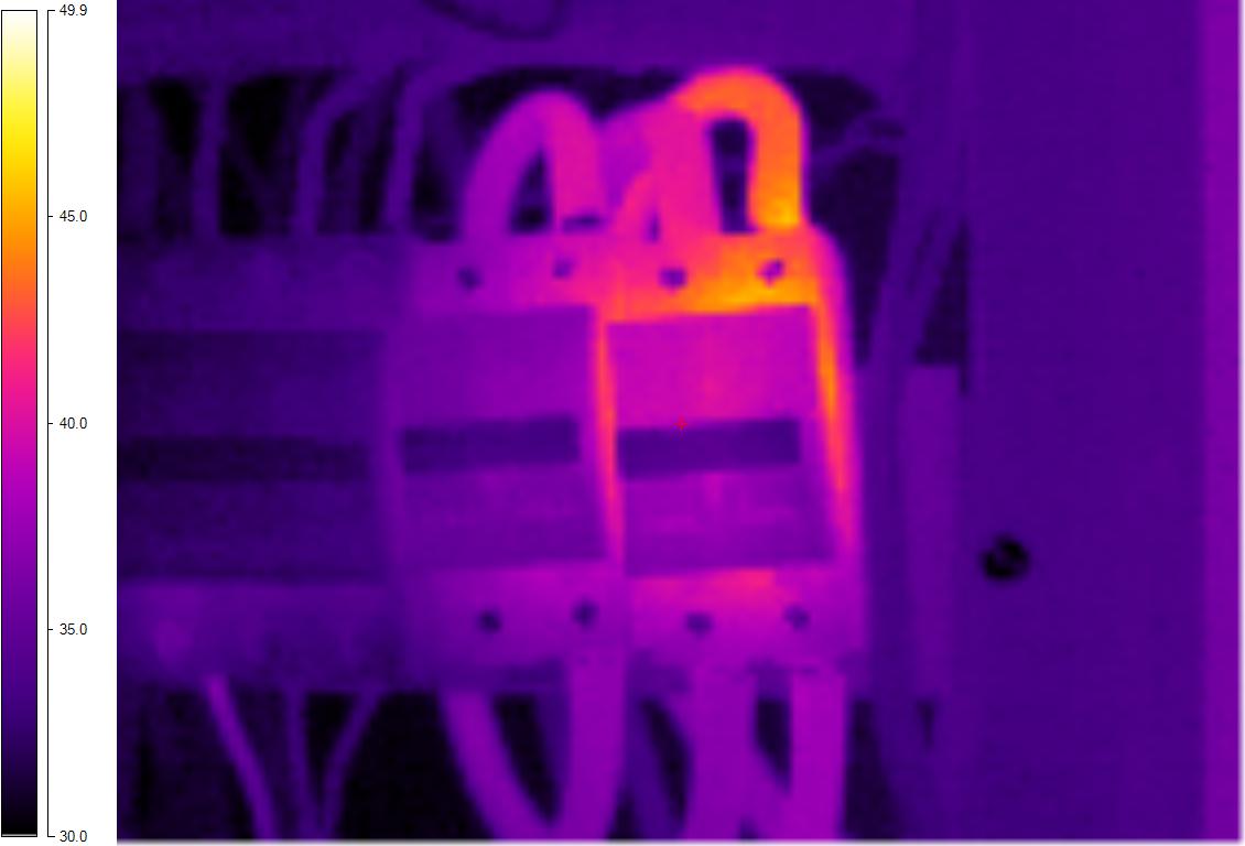

        this is an example of why it helps when the person doing the inspection understands the electrical system...this image not only has a bad connection on the blue phase...but has 2 double pole circuit breakers feeding a 3 phase circuit...if this circuit feeds a 2 phase motor for eg...if one of the circuit breakers trip and not the other you will cause single phasing then your problems really start because the motor will overheat and burn out...

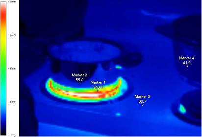

          this is one of my favourite images...it indicates how emmissivity affects the temperature displayed...the pot is at over 200 degrees but in the image it only indictes 55 degrees.
            • 22810
            Out of curiosity, what liquid is in the pot?
            • murdock
              • Oct 2007
              • 2346
              boiling water...the pot is indicating 55 degrees in the image but once the emmissivity is adjusted it goes up to over 200 degrees...as it is stated in almost every document i have read... even though i have emmissivity tables from fluke, flir and others i have found...the stranage thing is they have slightly different values but they are a good as a guideline...when an object has low emmissivity it is extremely difficult to determine the exact temperature...you also have to take a whole lot of other factors into account like reflective temperature...ambient temperature...type of material...which is why i am sticking to electrical installations for now...because of my vast electrical knowledge it is just another handy tool added to the collection of fault find equipment.

                • 22810
                And I'm guessing the pot is a polished steel...
                That was what I was thinking - that picture is a study in reflected temperature as well. You can see the reflection of the whole stove top on the side of the pot.
                Actually, given the water is boiling which puts it at a pretty specific temperature too, that picture is quite a study full stop.
                For difficult surfaces, maybe there is nothing quite like hauling out the old thermometer for benchmarking rather than relying totally on emissivity tables
                • murdock
                  • Oct 2007
                  • 2346
                  yip polished stainless steel...problem with the type of equipment i have be testing you cant put a normal probe onto it being loaded 400volts and sometimes as high as almost 3000 amps shiney copper.even when you take the camera close it starts distorting the screen from the current fields.
