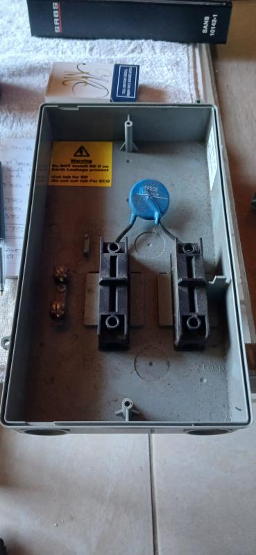

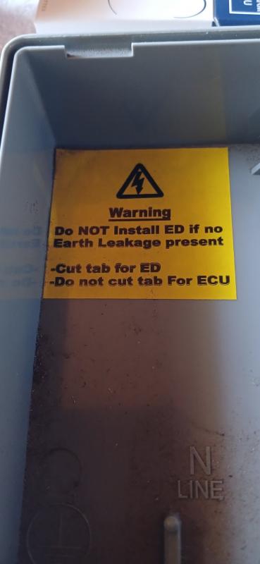

    Does anyone know what this means ?
    • 1473
    Can only think they mean, if there is an earth leakage unit before the meter then cut the mosfet ( ED - Electrical Distribution and ECU electronic control unit - I think ) other wise leave it in place
    Can think of no other reason why you would want the mosfet cut out
