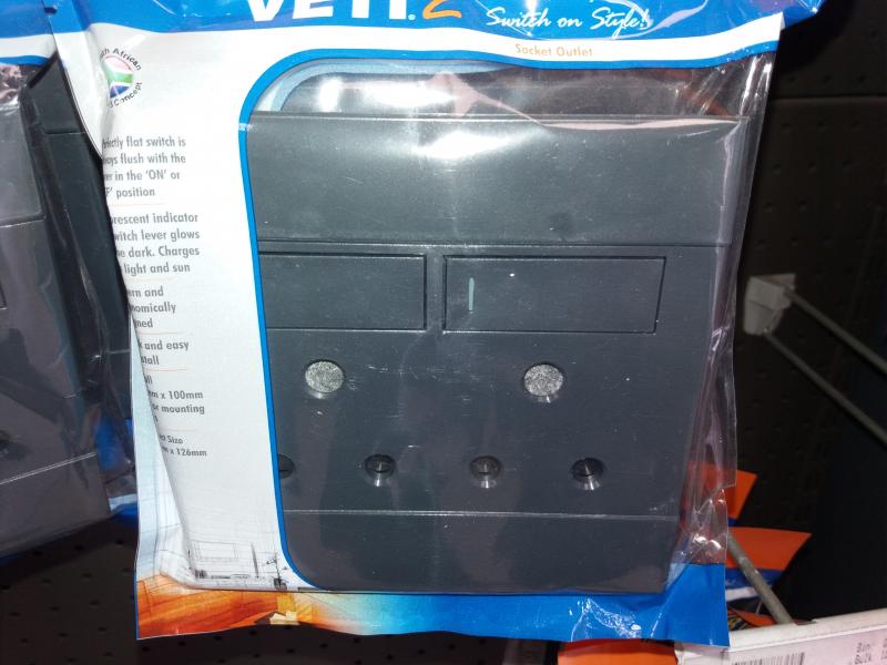

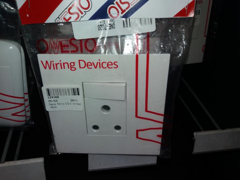

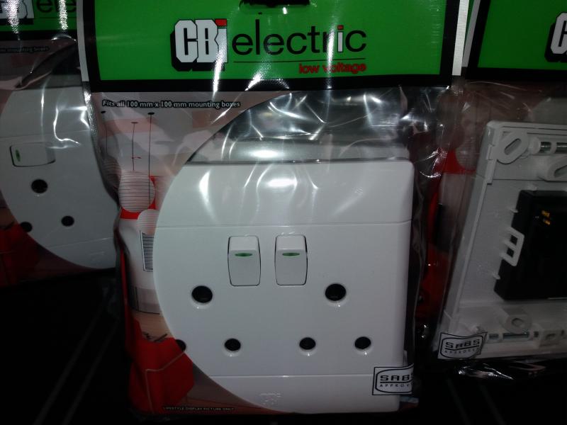

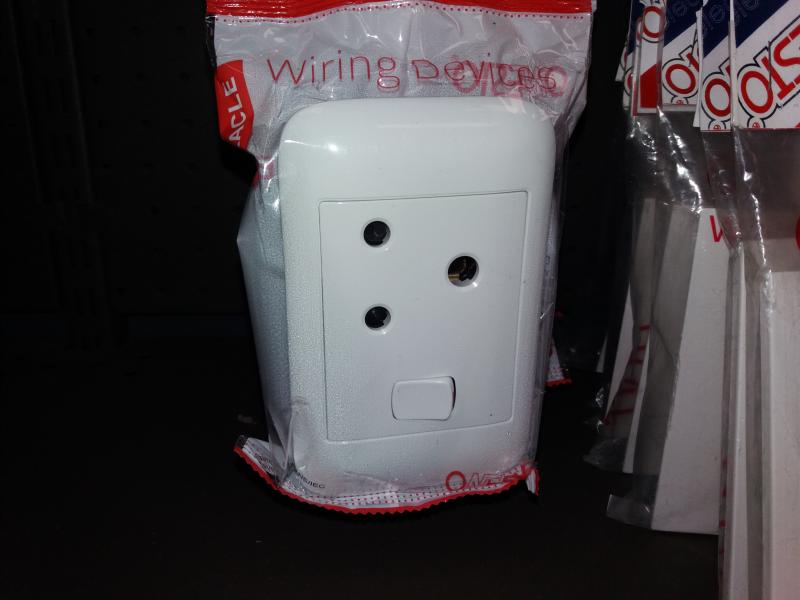

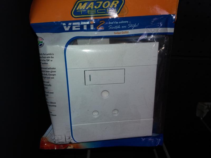

    What do the above plugs have in common ?
    There are many more, but I am limited to 6 photo's per thread.
    Peace out .. Derek
    The covers are all plastic and attach with clips...and of course they are not the new SA standard (I think.....)

        All have a switch for each point and also it appears that all bar the one have shutters? Interested to know more though
        Also all have plastic packaging so perhaps green peace a bit pissed off for single use plastic.

          Installing any one of them since January 2018 has been illegal. ( See SANS 10142-1 Reg 6.15.1.1.1.c )
          The question is .... Why, after almost 4 years of the reg taking effect, are they still being displayed and offered for sale by all the electrical
          wholesalers if it is not legal to use them ?
          Peace out ... Derek.
