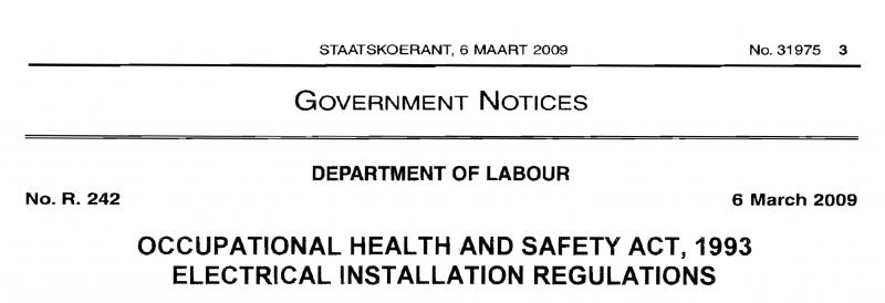

            I need to know exactly where the CoC validity period is specified. Kindly help me out.

                #172
                Greetings
                In the OHS act Section 7 under electrical installation regulations

                  #173
                  Originally posted by SeanM
                  Greetings
                  Thanks @SeanM
                  Just for reference it is Government Notice No. R. 242 of 6 March 2009 section 7.(5)

                    #174
                    Hi, the only mention of validity is for change of ownership. as for your question I assume it refers to the fact that how long are you responsible for the installation? Well the answer is straight forward as stipulated in OHS. You as the registered person stays responsible for the installation until something is change or added without a supplement COC. BUT you are only responsible for the following - INSPECT, TEST, VERIFY and CERTIFY so if this was done correctly on the day of your site visit you will be liable to proof that for as long as there is a installation and nothing has changed as mentioned above.
                    On the other hand as stated by OHS, the responsibility of the user or lessor is the SAFETY, SAFE USE and MAINTENANCE of the installation.
                    Hope this help.
